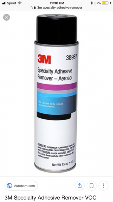

Recently debadged my ram and used a heat gun to remove the emblems. Had to scratch off the residue witj my finger nail. When that was done, tried turtle wax grease and wax remover. Took forever to remove the sticker adhesive residue.
Went and bought 3M specialty adhesive remover. Stuff is amazing and I highly reccomend. Got mine at napa for $28 for one can. A little pricey, but takes the adhesive right off.
If you plan on debadging, order this stuff online its a lot cheaper that way.

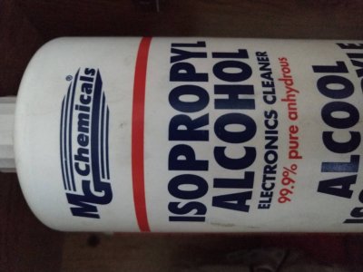

I use pure isopropyl alcohol(residue free electronics cleaner), but rubbing alcohol works also to remove the left behind adhesive.
It's also good for preparing an area if your putting something on with an adhesive.

The stuff I use is by MG Chemicals. It's not an aerosol.
I use it to clean my phone and the 8.4 radio screen, almost spooky how much dirt come off it.IMG_20180610_071612391.jpeg

The 3M adhesive remover is awesome stuff. I've been using it to debadge vehicles for years. It's also a good tar remover and won't hurt the paint.
If there are some stubborn sections I'll use an eraser wheel on a drill at low to medium speed.
A little rubbing compound will get rid of any grit lines.
Yup, that 3M stuff is great.
