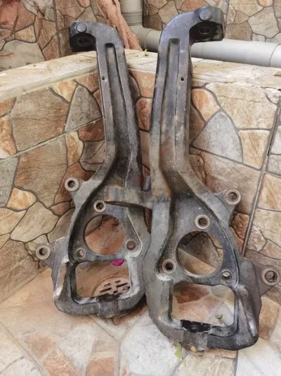

I've pretty much identified that this is a Superlift. I will be changing the rear coils and the shocks later down the line.
What makes me wonder is whether we are able to fit the stock 17" rims with the Superlift kit. I don't really want to go with anything bigger than a 17" for my truck.
knightjp
knightjp
Aug 9, 2014
1,049
1,298
Dubai, United Arab Emirates

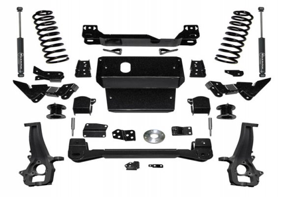

@DILLIGAF Thank you. I stand corrected. I assumed that it was the Superlift because of this picture.
Most of the other kits had dual rate springs for the rear.
Also the seller told me that the kit came off a truck with Bilstein shocks. So I immediately assumed that it was Mopar / Superlift kit.
I'm not sure.. but looking at the knuckles again, I believe that these are BDS knuckles. So maybe I've been going about it all wrong. Thanks you.
I guess that what what you get when you spend 160 USD on a lift kit.
