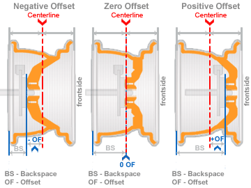

A +1 mm offset will basically be so close to having the hub in the middle that the extra 1 inch would effectively be split right down the middle, 1/2" on the inside, 1/2" on the outside.

The difference in offset on those would be about 1/2" with the -12 sticking out the widest.

Take a look at the pic below as it illustrates negative and positive offset pretty nicely.
