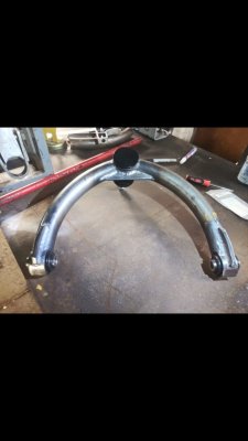

Icon delta joints are the best arms...but I designed a tubular upper control arm that uses the same joint as the delta joint, and my body mount use SPC X-Axis sealed flex joints. I called Icon and asked them why they don’t use those instead of the poly bushings they use, and they told me the don’t have a high enough of s demand.
Check mine out.

Does your arm relocate the ball joint for a better angle? Or is it just angled slightly in the stock location? The zone arms offset the ball joint slightly and angle it to compensate both ways.

I angled the ball joint when I tigged it, plus the added degree of movement from the SPC joints adds more flex.
