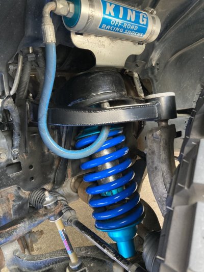

Stock are only fine when you have a spindle lift. as you can see my TTX UCA are almost level.
If he pushes his 6112 to 2.8 they wont be.
Ive been waiting for almost 4 years for my TTX to fail so I can upgrade to CORE 4X4 UCAs... And its not like I havent tried to break them...lol..

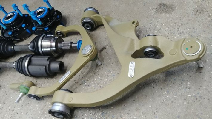

All my front end parts are TTX, I swapped everything out when I did the Gen 3 front diff swap. My OEM components were 7y at this point and bushings were shot.
Only thing that failed so far was one of the TTX wheel bearing. Was stating to get a faint howling noise. But there was zero play in it. my 37s and the way I drive is hard on those regardless of brand so I ordered up another one. The new TTX wheel bearing was different so I guess they have been updated. Will see how long this one last as I only replaced 1 side.
Not bad considering what I put that truck thru.
I looked at this photo again. Which axles did you buy in that photo? Which control arms are in that photo?
In ordered a pair of the Mevotech TTX wheel hubs for the front. Original driver front hub has been making some noise. No play in it that I can find.
Thanks.

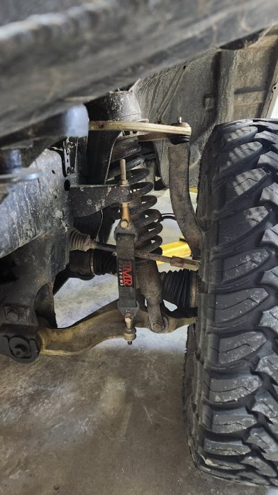

Hey Hangman,
Just wanted to share my current setup—I'm running Bilstein 6112s at notch #7 (2.4" lift) paired with MevoTech TTX UCAs, front and rear TTX sway bar links, and front TTX outer tie rod ends on my 2016 Ram 1500 Laramie. So far, everything's solid—no issues to report except the front sway bar link bushings are already starting to crack after just 30 days, which is disappointing.
In the rear, I’m running Icon coils with Bilstein 5160s and a Hellwig sway bar. The truck drives great. Not quite as smooth as stock, but still very manageable, even with Toyo 35x11.5R20 ATIII tires.
Alignment’s good and no issues with any of the TTX components. I also wheel it pretty regularly in Ouray, CO, and honestly, it keeps up with my buddy’s Tacoma just fine.20250424_115047.jpg
