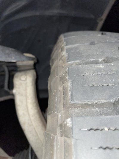

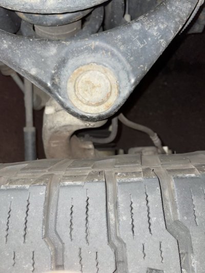

I can only relay my experience. These pics I just took. I have Bora 1.5” spacers installed. I tried to install zone uca’s without spacers and with the suspension drooped, impossible to remount my tire. As you can imag8ne, w/o the spacer, I was a few milimeters from the sidewall.
