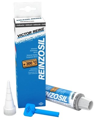

Where are you buying that at Ian. I need to do a bit of dash gluing ,and so far i haven't found anything that works for any length of time.
Rock Auto used to carry it for 9$ A tube. Never found it anywhere at a decent price up here. But AliExpress has it.
Learned about that **** when I stared working on VWs

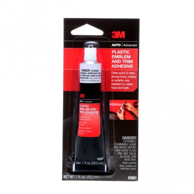

Hmm, I saw that stuff at O’reileys but I guess I didn’t see that it said it was for trim, too. I guess that stuff I was reattaching could be considered trim. Guess I’ll try that if the weatherstripping adhesive doesn’t work.
Worked perfectly for the one that peeled up on my Magnum.
Clean the channel with rubbing alcohol and use painter's tape to hold it in place while drying.

That was exactly what I did, lol. I cleaned the channels and the rubber stuff with rubbing alcohol the best I could and then I applied a small beac of the adhesive to both the cab and that rubber strip and let it sit for a few minutes and then as soon as I its reapplied it, it was stuck but for good measure I went ahead and took some masking tape and put on it just in case that it was on there for about two or three hours. Went out there and pulled the tape off and to my surprise this morning, both ends were still stuck and haven’t pulled loose so we’ll see.

Found it on Amazon.ca,but damn they seem to think it's gold plated.

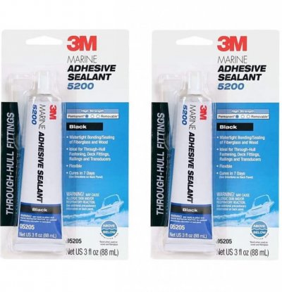

A clear silicone like 3M will work
use solvent grade alcohol to clean before application
place plastic stretch wrap between door and frame while curing.
Unless “top of cab” is meant to be “roof of cab” and “rubber strips” are instead “body moulding” then forget the stretch wrap and use aircraft or marine grade adhesive

When you absotively posilutely don't ever want it to come off ever again lol. We used to use this **** when I was in USCG to seal soft patches, outboard brackets to transoms, etc. Whenever we removed an outboard it generally took some gelcoat with it lol. The soft patches to remove the larger diesels generally had to be damn near chiseled out and generally had to use a come-a-long or hoist to pop it loose even after all the bolts had been removed.
Mister Luck
cassis tutissima virtus
Aug 25, 2020
1,651
606
WEST COAST
2016/2017
5.7 V8
Disclaimer: 5200 can be applied underwater and care should be made not to create air pockets inside as these may trap contaminates and or moisture.
In general it stays in a flexible state.
its best to use small tubes because once opened the shelve life is only three to five days at best, you can cut open the tube and use a spatula type tool for application if the neck and cap (after opening) become fused together.

Why are you telling me this like I've never used it before?
