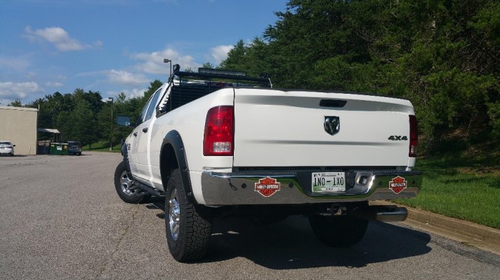

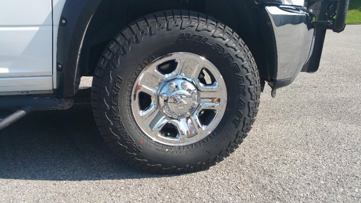

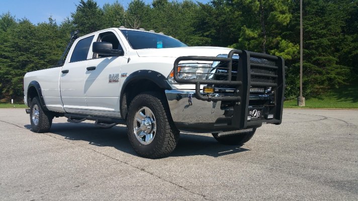

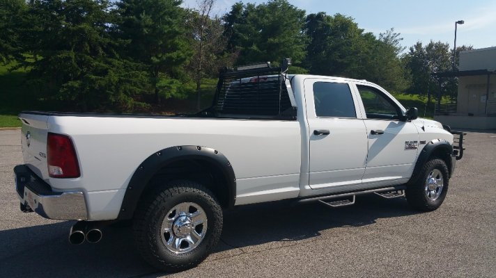

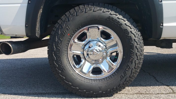

My 2017 2500 6.4 CC 8' bed Tradesman came with the 18" chrome plated wheels with 275/70R18 tires. I recently replaced the tires only with 285/75R18 Falken Wildpeak A/T3W's.
The 285/75R18 Falken Wildpeak A/T3W has a diameter of 34.8", a width of 11.2", mounts on a 18" rim and has 599 revolutions per mile. It weighs 65.9 lbs, has a max load of 4080/3750 lbs, a maximum air pressure of 80 psi, a tread depth of 18/32" and should be used on a rim width of 7.5-9.5".
I'm like you, I like more tire and less wheel diameter filling the wheel wells. This did it for me without needing to buy new rims. They tow great, have all the load capacity you need and at only 11.2" wide, they don't kill your gas mileage. They work well in snow too. Wide tires suck in the snow. I'm very happy with them looks wise and performance wise. Much quieter than the M/T's I have always run, until now.
If I could put 15" rims on it, I would. Love that look. Had **** Cepek 36x15-15's on a '76 K5 Blazer and loved the big tire, bouncy look. I'm old, what can I say. I like the 70's look. My 2 cents. Hope it helps.31192eb8ed1f34e9ff593d36632ff38d.jpg91d12072610d3f1de7ab015ba28bb5dd.jpge782bc9ae7dcd0484783aa764c6aa1b9.jpg0118c57f9857e0b4d6f3d434efd14f2d.jpg3c73d1a11fd224cfa22ecf54ce365eaa.jpg10ab997997fd783a897b34d9048b9531.jpg

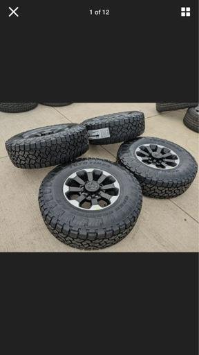

Racing Woody
Racing Woody
Dec 10, 2018
122
100
Dublin, OH
Thank you all for your advice.
My truck is a work truck and I am on Job sites daily. Not off roading but not on the street and 20's with low profile tires I am afraid I am going to bend a wheel.
Low profile on my sports car is a different discussion.
The PW's factory wheel is an 18 not a 17 at least the ones I am looking at, Black with polished face. So I will probably jump to these and grab tires that handle the load I need.
Thanks again.

Racing Woody
Racing Woody
Dec 10, 2018
122
100
Dublin, OH
I wouldn’t recommend PW wheels for a tow rig. The 17” are better for off road but probably one of the many reasons these trucks have less tow capacity. And don’t get enamored of tall tires either, I can certainly feel an increase in side to side motion with a trailer resulting from tread flex after changing from 33” to 35”.
Didn’t realize in my original response to this. The older PW wheels are 17”. The 2019-2020 PW wheels are 18”. Both are black with polished lips.
Just to clarify.
Thx

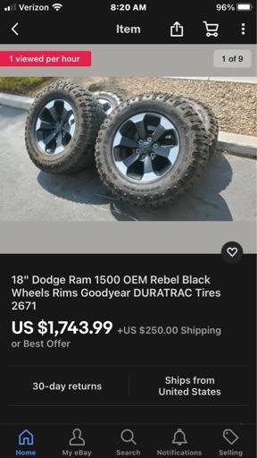

Woody, I don’t know where you’re sourcing that information but as the owner of a 2019 PW that I purchased new, someone is steering you wrong.

Racing Woody
Racing Woody
Dec 10, 2018
122
100
Dublin, OH
Again, in my haste to make wheel decisions I am scrolling to fast and not reading everything properly when looking through eBay listings.
The wheels I have been looking at I swore were labeled as 18” wheels. But yes they are 17”.
I guess there is a newer version of the PW’s, or again maybe these are not true PW’s that are 18”.
Either way for now I am sticking with the current 20’s. Thank you for checking me, as I would have probably moved forward buying the PW’s that I thought were 18’s. Not interested in going down to 17’s.
Thank you.

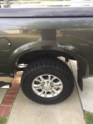

Here is my setup and i love it. Cooper ST MAXX 295/70/18. Great ride good in wet weather and great in the snow. Off road is good for where i've taken them. Stock Laramie Wheels.
