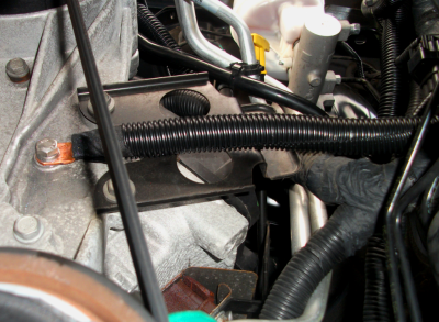

If you don't want to do the big three completely I would at least improve the factory ground locations in the engine bay. I removed the paint at those locations, reattached the ground wires and coated the outside with liquid electrical tape.

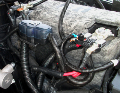

I can attest the big 3 does do something. I did it on my 14 Express and it eliminated the dimming. Just completed it on my 17 Sport in 0/1 gauge but don't have my system completed to comment on that yet.
Nice. Pics?

One thing I did notice, the grounds are **** in this truck, sitkneelbend has a great idea by puling them and taking the paint off as factory just mounts them
right on top of the paint, Then shoot some clear coat on them for protection
even the frame ground is garbage , may run a new wire as it is only a 10 gauge ground wire to the frame ???
They ground to the chassis in two places that I could find again with 10 guage
None of the factory wiring for the alternator or anything else for that matter seems to exceed 8 gauge.
