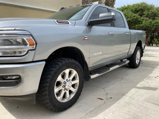

I went with a 275/65 20. 34 inch tall and only about an inch wider. I really wanted to put on 35s but didnt want to risk a spacer or buy different wheels.
