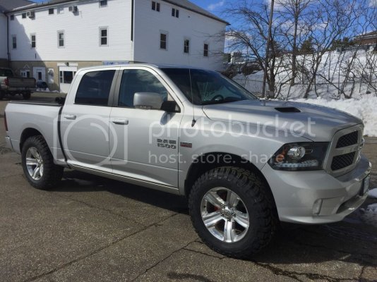

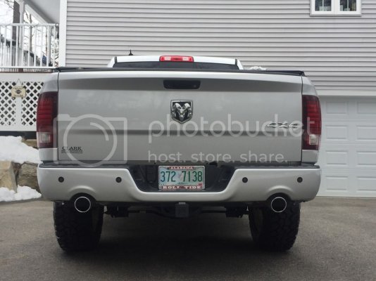

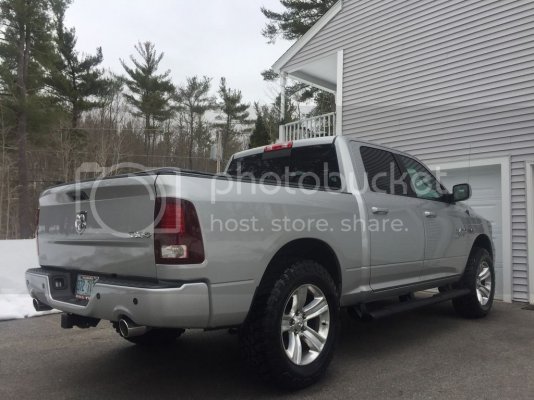

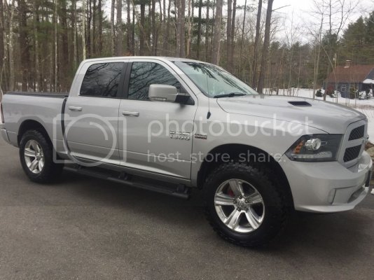

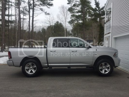

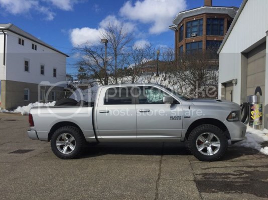

Installed my bilsteins this weekend finally after having blown front shocks for 3 years. I did them at 2.8, so the rear end is a little off. I intend to run a rear coil spacer if I can't find larger springs (I looked on TGC and can't find them???). The photo of the dry erase board is the measurements to the wheelwells (right is the front); you can see the front is a bit higher.
Anyways, I couldn't find a whole ton of photos with 295/65-20s on stock sport 20's on a leveled truck so i figure i would post some up.
The tires are awesome. They measure about 35.5" high and around 11.75" wide. They balanced well and I have gone up to 85mph with no vibes or problems. I have ZERO RUBBING in any condition, and I do not have wheel spacers - since I know it will be asked. Noise level is very low but all I have to compare is to my 33" duratracs on my Jeep TJ which I didn't find loud either.
I'm very happy with it overall, wish I did it 3 years ago haha. Rear bilsteins will go in when I get my coil spacers. I may post some more pics to show any difference.
