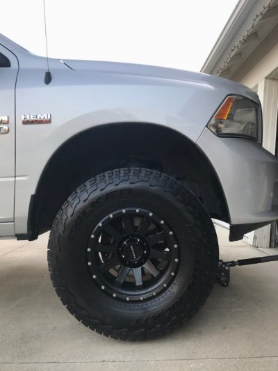

You went a little low with this camera angle, try to snap the pic little above that.
Is this with a spacer on top of the strut, or a preload spacer + Billies at 2.1?
Aside from a better CV angle, the other interesting pictures will be your UCA angle at rest, and just for chit and giggles, lift the truck from the center front, and take a pic at the angles of your UCA with the struts at full droop...

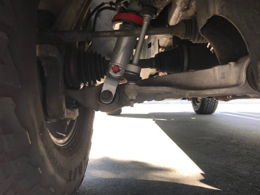

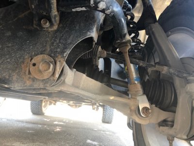

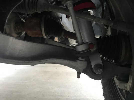

So here you go, UCA at rest
45367491965_6b9d7af7b8_h.jpgUntitled by Wrangler RSM, on Flickr
45556591044_d0652829b7_h.jpgUntitled by Wrangler RSM, on Flickr
CV angles at rest
45171481614_7a38decb4d_h.jpgUntitled by Wrangler RSM, on Flickr
Now lifted from the front, letting everything droop with tires off the ground
46229910392_532bf8b8dd_h.jpgUntitled by Wrangler RSM, on Flickr
UCA's at full droop
32408523758_8821fedf2b_h.jpgUntitled by Wrangler RSM, on Flickr
45556499544_8bc3c44790_h.jpgUntitled by Wrangler RSM, on Flickr
CV angles at full droop
46229916372_05a3e50804_h.jpgUntitled by Wrangler RSM, on Flickr
46280040351_6d9a9707a2_h.jpgUntitled by Wrangler RSM, on Flickr
Most important things for you will be to check how your UCA BJ's look like at rest and full droop, same for the CV angles, if you have a spacer on top of the strut, things might be bad for you stock parts depending on the size of that spacer, there seems to be some nice front room in this trucks though, i guess because of the factory air suspension can lift things 2" from the normal resting position, and FCA may have designed some wiggle room in our trucks geometry so we seem to have some more room to play compared to other applications that don't have such feature, but past 2" though might be a different ball game.
