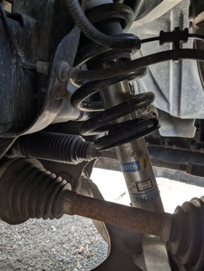

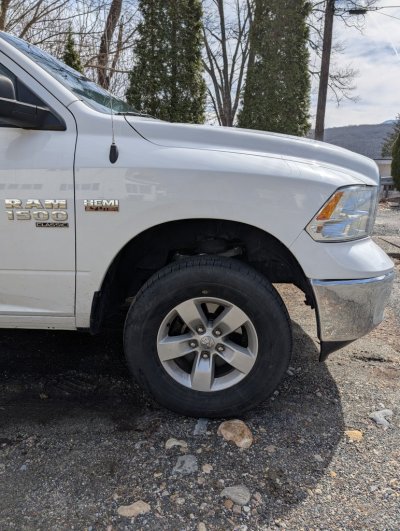

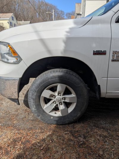

Hey all new ram owner here, just leveled my 2020 classic with Bilstein set to the second highest setting and now noticing my driver front sits lower than passenger? Gonna wait a little to see if the one side settles after driving a bit, but is this normal?

Are you sure they're set the same? Maybe it's just the angle of the pics, but...
Drivers side is good passenger side the spring is clocked wrong. The spring perch should look like a mirror to the drivers side. Also more times than I can count since this are truck springs and not car springs if the top nut wasn’t torqued with the spring compressed enough you’ll develop a bird chirping noise and will need another set of 5100’s to start all over again.
As to your settling theory the springs you re-used have already settled 74k miles ago.

When the weather starts getting good around me again and I have a weekend free I'll definitely tear it apart myself and turn the spring perch to mirror the driver side. From the looks of it the end of the coil should be facing the direction inwards towards the engine bay correct?
Yes that will allow the spring to sit where it was from factory and avoid spring bow
Again you need a professional grade spring compressor the threaded ones don’t have the force to torque the top bolt properly
