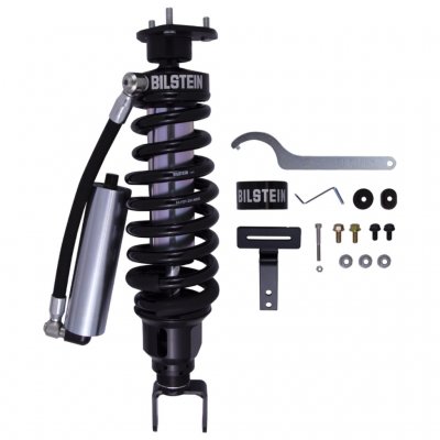

As the title says, would those coilovers fit on our 4th gen ?
I've seen some post about it but wanted to have a clear answer.
If yes, what pros/cons would it bring ?
Thanks !

They're not showing in the Bilstein USA catalog for the 4th gen RAM 1500, only showing for the 5th gen. But technically they should fit in our strut mounts as everything in there is the same. The problem will be if they will really fit in our application or not. If i remember correctly stock vs stock the difference is mostly where the coil pearch is resting so if you were to install 2021 RAM 1500 struts in your 4th gen i'll think you'll see some extra lift. Since these are coilovers you can adjust the height as any other CO. They have literally exactly the same length specs as King 2.5 or Fox 2.5 CO's so they should work in our 4th gean application. But if you're committing to it make sure they'll fit or know for sure you can return them if you tested them and they didn't fit. If you can have a pair and compare them side by side to another CO specific to the RAM 1500 you will know right away. Maybe a trip to a 4wp or ORW or any other place where you can have them in your hands will work.
Pro's they're race 2.5 coilovers, little more advanced than the OE options from Kings or Fox 2.5
Cons, more expensive than King or Fox OE 2.5's if you want to see price as a Cons :)

I looked at those as well. They would technically give you more lift than advertised being you have a 4th gen. I’m still contemplating buying 5th gen 6112s and setting them around 1.5-2” since that should be 2.5-3” in our 4th gens and putting them in my truck. They are 1/2” longer extended than 4th gen 6112s but also only have 6” travel vs the 4th gen 6112 at 6.25” travel. Not sure .25” is enough to deter me from buying the 5th gen version. Valving is slightly different I’m assuming too.

They look offset to one side or the other, would that have any impact to fitment?

If its to offset to the front, its actually a good thing, Will give more clearance for the CV shaft.
My 6112's are pretty close to the CV Shaft

@ram1500rsm In all your wisdom, do you happen to know if the 8100 would fit in the back ? I think I saw something about the top mount being different or something like that, but can't remember.

The 5th gen top mount is not an eyelet like 4th gens. And the offset would be good because it pushes the strut away from the cv. You have a designated driver and passenger strut with that setup.

The 5th gen stock top mount is the same as 4th gen. The 8112 is something custom from bilstein
Edit: sorry. I’m not thinking straight. Lol. The rear top mount is a through style bushing mount not an eyelet like our trucks. The lower mount is an eyelet for both

No. The rear upper mount is different. Plus their length is literally the same as your stock rear shocks so you wouldn’t gain any rear travel.
