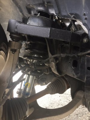

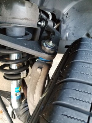

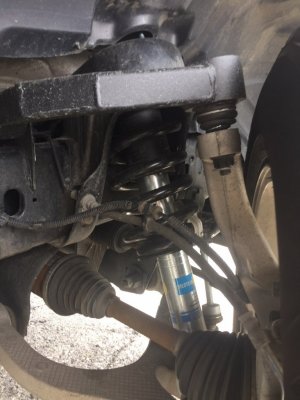

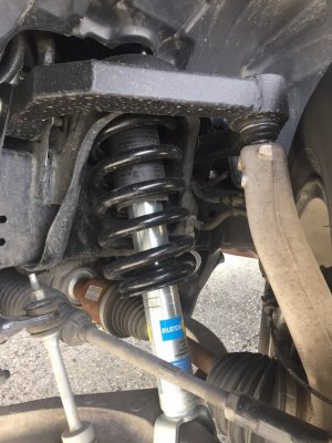

Here's some pics with the wheels clocked both ways. I did double check the top nut and it's as tight as I can get it with the allen and pass through socket. FWIW during the install I did compress the spring enough so that I could ensure that the top nut was bottomed out on the threads.

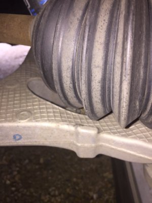

Well I torqued the sway bar end link nut to the spec'd 16 ft-lbs after realizing it can be done with the help of my misplaced small torque wrench. Also looked at the knuckle and lower control arm for rubbing. Looks like the lower control arms are okay but appears that there is some minor rubbing on the knuckles. Might very well be the problem as stimpy433 suggested. After torquing the end links I took the truck for a drive down a dirt road with plenty of washboards and pot holes and no clunking noise whatsoever. I didn't try any tight turns though... probably just go back to that same curb that made the clunk the first time and see what happens. Guess it's somewhat assuring that this has happened to others, but dammit I don't want to hear any noise from the front end of a new truck lol.

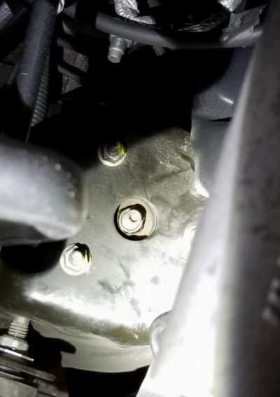

I just had mine done today, all went well I thought but tonight I happened to go over a speed bump and got the dreaded clunk.
I spoke to the shop prior to install and they were aware of the washer under the top hat deal so I don't think that would be it, so maybe it's something just not fully tightened down?
I will stop by the shop tomorrow and have them double check everything I guess.

I went out and looked down via the engine bay, I'm not seeing any washers from above, which I believe is a good sign. I'll report back tomorrow after I run by the shop.

See the top of that bolt?
Seems that not torque that bolt down, properly, because it moves when doing so, is another top reason for clunks.
Best to use a straight thru socket and ratchet, that way one can place an allen wrench thru the socket, to hold bolt in place, while turning the the nut.

OK I will check in the morning, engine was still pretty hot so I didn't want to start reaching down in there, just took the pics :).
It looked like a good amount of thread is showing, but sounds like there should be more? I'll see if there is any movement in the am.

Well we found the issue...
And these are not stock UCAs, they are Procomp. So replacing with different brand.
