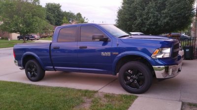

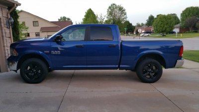

So I had the Bilsteins installed today along with an alignment on my 15 Outdoorsman . I went with the 2.8 setting for the reason that people were saying that the Outdoorsman replaced the TRX and at the 2.8 setting I would actually only get 2.1 " of lift due to the fact of the TRX and Outdoorsman being .7" different while others said that was not true.
The results..
Measurements were:
Before
front left 36.5 "/ front right 37"
Rears 40"
After Bilstein installed at 2.8
front left 38 & 5/8" / front right 39 & 1/8"
So according to my measurements that is exactly 2.1 " of lift even though I set them at 2.8 so the rumors of the Outdoorsman somehow being .7" different stands true for me.
VERY happy with the look but disappointed that I am one of the ones that ended up getting the vibrations on acceleration while in 4wd.

My Laramie was the same 37" on the right front from the factory, and 39 1/4" with the Bills at 2.8. Sounds like your results are very typical and no different than the non-Outdoorsman.
Getting a true 2.8", given the stock front that's typically 36.5-37", would put you close to 40" in the front. Never heard of anyone ending up that tall with just Bills.
Either way your truck looks great! Although it's screaming for more aggressive tires now :waytogo:

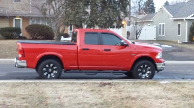

I just bought Bilsteins and was going to ask at what setting to put them. I have a 2012 outdoorsman and have been running a 2.5 spacer for 3 years now. Wanted to get rid of it. Now I hope I don't lose what I have now. We'll find out I guess. Here's how she looks now.

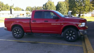

My outdoorsman with bilsteins at 2.8". I previously had 2" spacers before installing the bilsteins. Never did measure the height, but my wheels and tires fit just fine.
