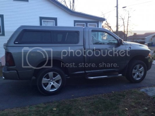

I installed my bils front and rear yesterday along with a 1" rear spacer. sits level.
