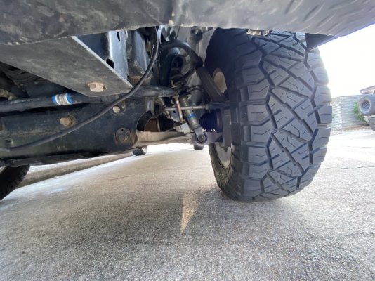

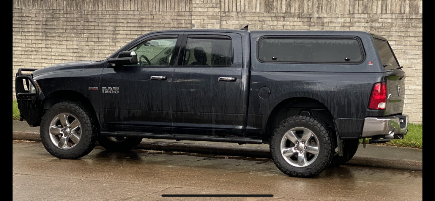

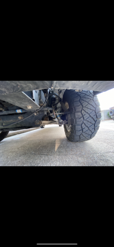

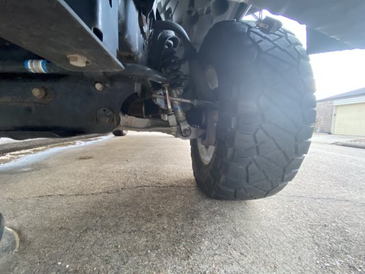

Alright guys, update time. So I went back and looked I measurements from before and after my bils at 2.8 and realized I really only had about 1.75-2” of lift out of them. In the rear I had about 1” of lift ( in the rear I had a 2” spacer and TTC-1211s with bils 5100.
So I took everyone’s idea of using the RC .5” spacer on top of my bilsteins at 2.8” and it wasn’t quite what I was looking for. So instead I got some 1.5” maxtrac spacers and added them and it’s almost perfect. In regards to clearance I don’t have any issues, I’ll have to check with my wheels turned to see if that makes a difference but with wheels straight there’s no issues. My upper ball joint is perfect and my CV and LCA are hardly pointed down. Ride feels great and no vibrations.
In the rear I kept the same 2” spacer but put on TTC-1223 springs. We will have to see where they settle at but I’m surprised how much higher they make the truck sit even with the extra weight I have on my truck at all times. I’d have to say I love the TTC-1223s as far as control goes. They definitely rebound less when hitting big holes and bumps than the 1211’s. I’ve got a set of FOX rear shocks that are 28.00”/16.6” to go on the rear. At full droop my springs won’t come unseated and my brake lines track bar and sway bar links will still have some travel left in them. I also added a new adjustable track bar. Last thing I gotta do is add my new bumpstops.
I appreciate y’all’s help and insight a lot!
I’ll be adding pictures shortly.
