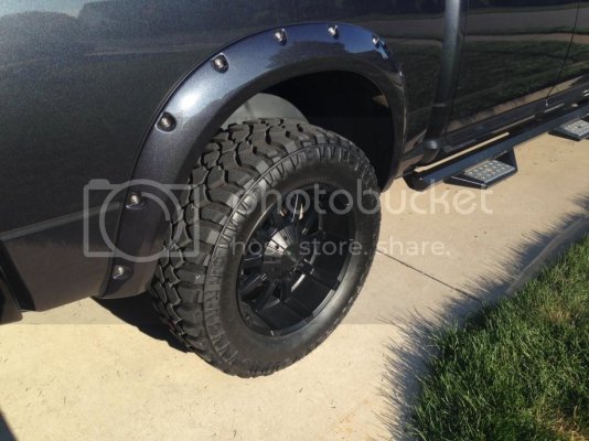

the flare in this picture has one coat of Bilt-Hamber cleanser polish and one coat of hydra wax, the rest has cquartz uk and one coat of reload. the tire has 2 coats of tuf shine.

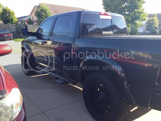

this is a wider angle of the same side (same products)
i find the Bilt-Hamber Cleanser Polish worked really well to give great shine and gloss, just as good as the more labour intensive machine polishing step on decent paint. The cleanser polish buffed on and off easy, and the hydrawax a dream to use!
here is the drivers side. On this side, I used Bilt-Hamber Auto Balm. now this product was slightly tougher to use, but once i got te application process down, it was smooth sailing. when i saw apply this thin, i mean thinner than anything youve ever used. i found it easier to use when i used the applicator slightly wetter than damp, and had the panel lightly misted with water. I did two coats of the autobalm and one coat of hydrawax. the second coat went off and on like butter. Again, i am very impressed with the depth of shine and gloss from this product, but it is a tad more difficult to use.

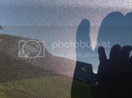

here are a couple pics of the flake....it really enhanced the flake to me!

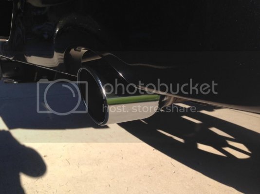

and one coat of autobalm on the tips...it really cleaned the tips up with no effort at all. they could use more work, but they were dirty, dull and covered in black....they turned out great for 15 seconds of polishing in my opinion!
