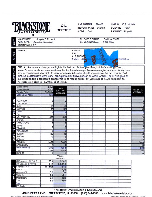

I will go back and post mine here as well.
The first one was a one year OCI with a ticking hemi cured by redline, the second one is a two year oci, and soon to come a third uoa with another 2 years on the oil, 10k miles. These are 5w20, the next one will be 5w30. The second one I changed the filter at 14 months and topped off, the next one I went the entire two year just on the oil and RP filter no added oil needed.

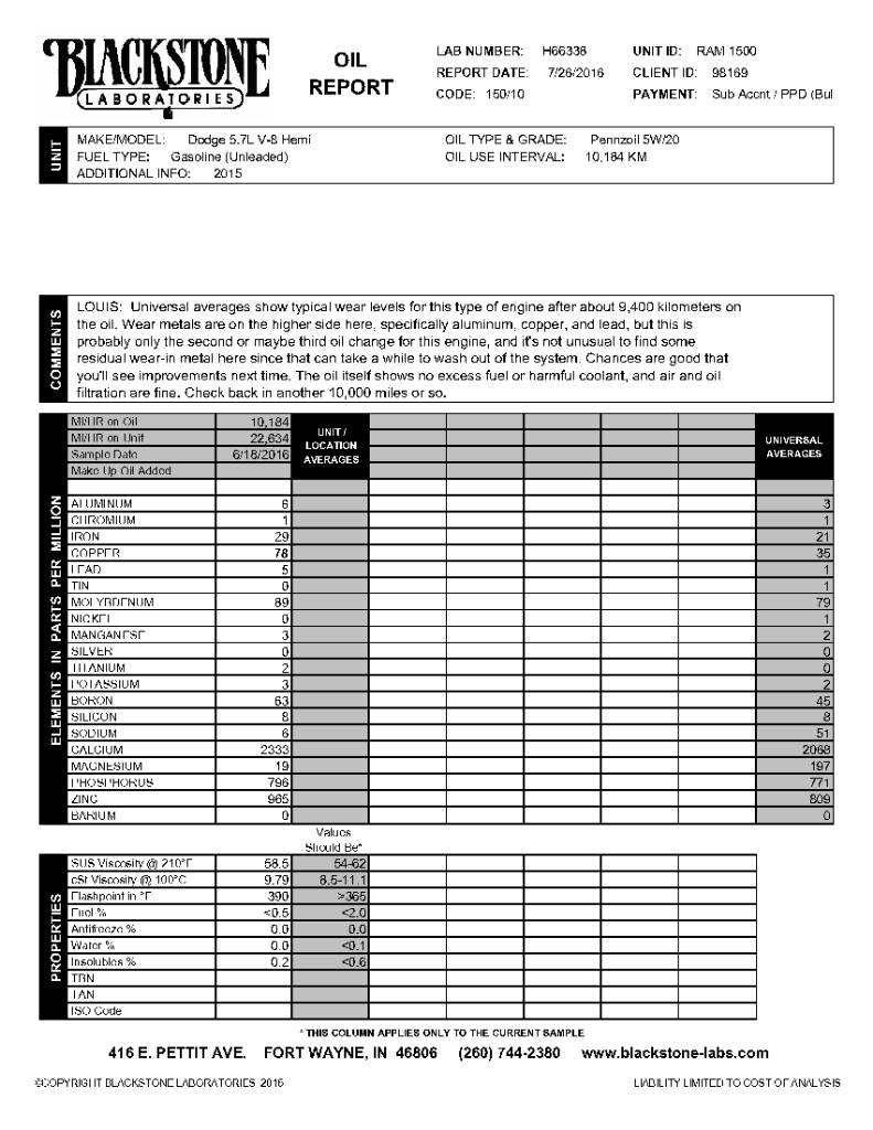

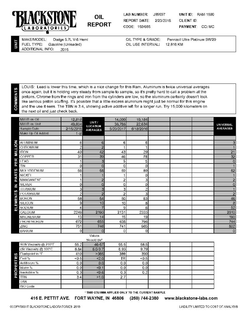

I currently have PUP 5W-20 in my truck now and when I change the oil I am going to take a sample and send it off to Blackstone.
After all the positive talk of this oil, I am surprised to see the low levels of Moly in it. But still, it is holding up real well.
Nice report.

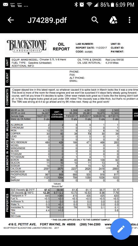

This is my last UOA, Redline 5w30 and a RP 20-82015c445573c0c925d8def53bb36cd7a3e.jpg
What are the different brands on the page, and explain the mileage? Some of those were short runs.
First one is 2500miles PYB 5w20, next one 1500 miles is Redline 5w20, next one 4100 miles is Redline 0w30, next one 3300 miles is PUP 0w40/5w30 mix. The short runs were me testing oils trying to quiet Hemi tick...
