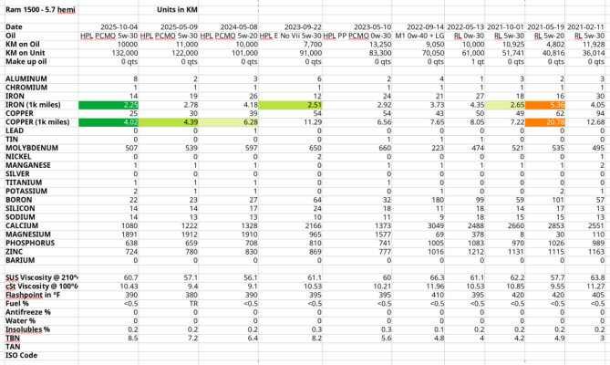

Just got my latest report for Oct 4/25. Very happy with this one, the others were great as well but this is the best iron and copper per 1000 miles, really high TBN yet, stayed well within grade etc.
Blackstone flagged the aluminum but some of that is part of the virg|n oil and shows up in many HPL UOA's, like this one from bobs. So I'm not worried about that in the slightest since the other wear metals are all going down. BS said AL can come from piston wear due to heavy towing, which I also do somewhat (not "heavy", but quite a bit I'd say, more than many half tons see).
The very minimal fuel dilution from previous winter run disappeared too, kind of expected that, absolutely no remote start/idling in the summer and it sees much higher temps too in the summer (with my 180 in the winter it never gets past low 90s C).
I'm running HPL P+ right now for the winter as I had some left over from 2023 and wanted to use it up, but the plan is to continue running the cheapest PCMO 5w-30 year round.
Guess the ole girl deserves to stick around in the driveway for another year :)
**Units in KM'S** Except for the two iron/copper marked at 1k miles where I converted for easy comparison to other hemis.
Edit: confirmed by David Ward, AL is a non issue:
