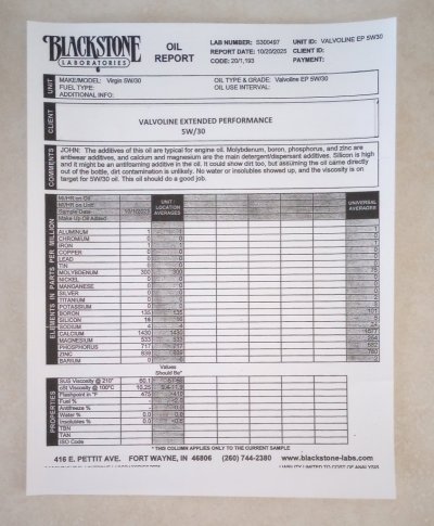

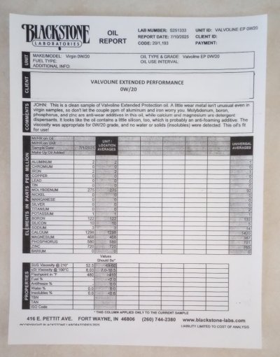

A couple of v I r g I n VALVOLINE Extended Protection 0w/20 and 5W/30 oil sample reports that I sent to Blackstone last July/October to see "what is in them".
Thought that that I'd post them for viewing ...
$8.97 at the"Wal-mark" where I reside.
Note: I made an error when copying the brand type and labeled them Extended Performance when the actual brand type is Extended Protection.
