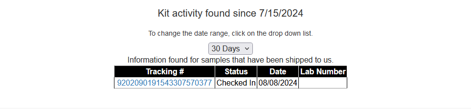

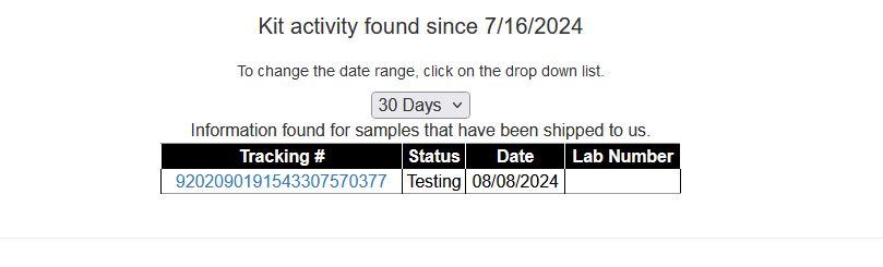

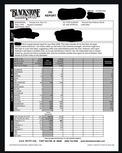

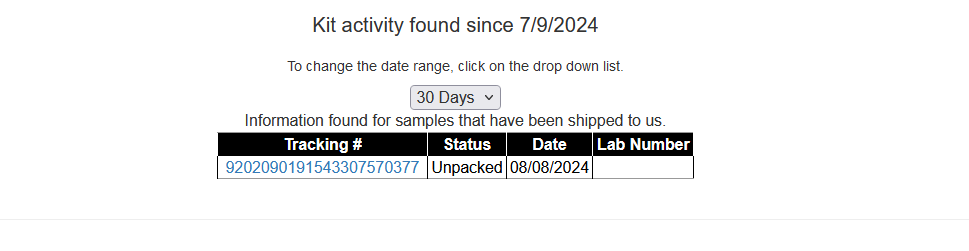

It took a month for my oil report results from Blackstone Labs, I was beginning to think they lost my submitted oil sample.
I seem to remember seeing folks posting a pretty wide range on
turn-around time. I have sent 2 separate samples last fall, each
seemed to take a lot longer than the experiences others have had.
I'm not trying to make a point with this, just thinking I would post
updates as I get them, just to see what a typical and random time
frame turns out to be in this one case.
My thoughts are that Blackstone is generally pretty busy and we
should expect a certain time frame for a lab result. People on YT
sending off 5 samples or maybe 20 samples at a time seem to be
pretty popular. I'm sure it takes time to work through large numbers
of samples and still produce reliable, quality, and consistent analysis.

They have been like that most of this year of what was usually a 2 week turnaround has turned into 4-5 weeks.
I have seen videos of Blackstone's operation and it is not really scalable for increased workload and keeping the same turn around times. They have a lot of manual labor touching operations from receiving, testing and to generating the report. They have customers that pay extra for priority service that pushes everybody else down that much farther in line.

Looks like they improved the formula a tad over last one, hopefully that stays. 100-150 more mag and 300 less CA is exactly what I would prefer, boron up as well. As for wear, just young engine stuff, around 40k miles on truck you will start seeing better numbers my guess, nothing out of normal here.

What Blackstone said about alum, I thought a little out of bounds, yes it's there but still low. We see this all the time on cold start hemi's.
