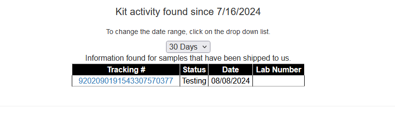

Multi-quote is not working as expected, so here we are as of the latest
stage of the process, today...
08/08/2024

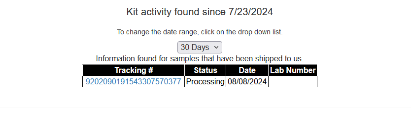

08/14/2024

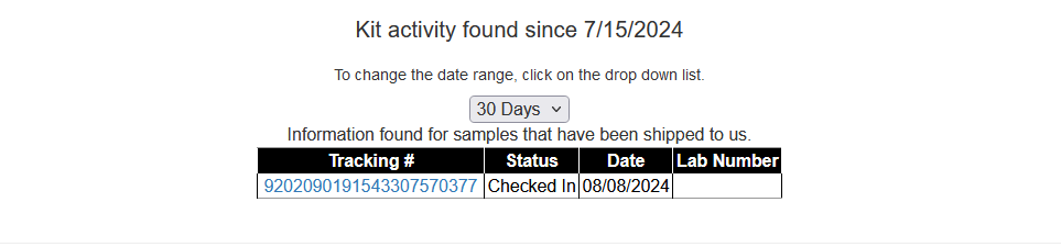

08/15/2024

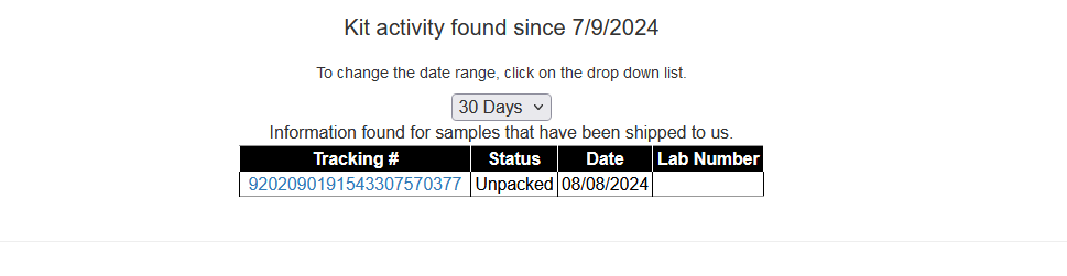

08/22/2024

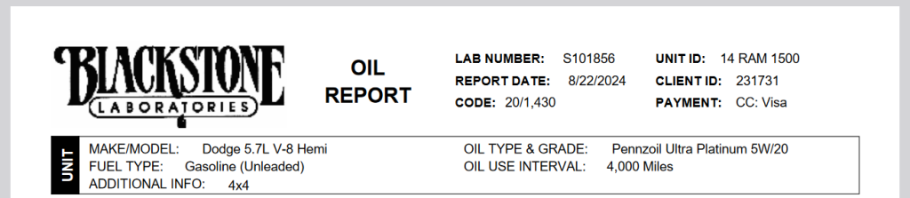

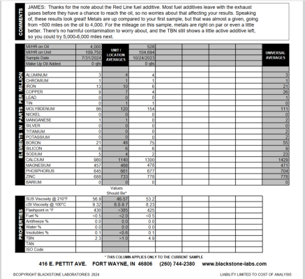

Results are in. This UOA is from oil/filter installed 12/2023, it is P.U.P. 5w-20 and a RP 20-820 filter and no additives. Also no oil was lost during this interval, dipstick had oil up to the full mark for the duration. No towing or load carrying on this UOA, just a DD.
Sometime in May 2024 I added 2 bottles of Red Line si-1 to my 26 gallon tank, the same time I installed the Moroso catch-can. I have been using only "brand name" Top Tier gas for about the last year, Shell, Sunoco, Exxon. I have drained the catch-can once and saved the goo, it was the last day for the PUP 5w-20 as I had the oil changed the next day.
Currently my truck is running Red Line 5w-30 with a Purolator Boss PBL24651 oversize filter, still no oil or gas additives. Also same air filter since 12/2023 since it has only run about 4000 miles. The engine is running so smooth and quiet right now that the cabin fan set on 3 makes more noise than the Hemi at idle. Neither I nor my wife can tell the engine is running. Even the radio antenna is completely motionless at idle. So far I am really liking this Red Line 5w-30.
Side note, I get a little noise from the left exhaust manifold on 1st start of the day. My oil-change mechanic confirmed when he noticed one bolt completely missing. He said he didn't mind tightening loose bolts but wouldn't mess with missing or broken bolts. So I'm currently looking for a better mechanic.
NOTE: The UOA at 528 miles. This was supposed to be PUP 5w-20 installed by my Ram Dealer, but it came out as black as coal. I no longer trust that dealer for anything. This 4000-mile oil came out a medium brown. I wish I had something more scientific, pics/video/anything. I didn't see this coming.

This oil report looks good.
I'm interested with your next uoa of Red Line 5w/30 and that "rock catcher" Purolator Boss oil filter, lol ... I'm currently using the same oil/oil filter and still a little ways to go on sending it in for an uoa.
I've used the Purolator Boss PBL 24651 many times with good uoa results from Blackstone Labs. And, it's easier to "aquire one off the shelf" and is made in the USA.

Me too. Well, it took me 8 months to run 4,000 miles so I'm not holding my breath on my next UOA. I'm probably looking at late Spring - early Summer 2025. I suspect we'll be looking at yours first.
Might be an apples-to-oranges comparison though, since your engine was dropped on it's head as a child. :oops: :rofl:

For a hemi that is about perfect for a uoa except for tbn, not sure why it was so depleted at 4k, mostly city driving? Very impressed with those numbers, I would expect the first run on redline for wear to go up a bit. I'm not sure you need the redline, but that butter smoothness is addictive.
The 528 uoa looks like pyb or blend or PHM, if it was synthetic probably pp high mileage.

Yes, definitely: city, grocery-getter, daily driver. Many runs are 9-10 miles round trip.
As for the Red Line choice I really wanted to get the Hemi back on a good 5w-30, and after reading through months of posts it seemed the RL was a solid choice even though it would be overkill, but it didn't seem to be overkill in a bad way.
And there are likely les expensive but very good 5w-30 options out there, but with 1-year OCIs I'm not concerned about spending extra for good fluid.
You're spot-on about the 528 UOA. Reading through the dealer receipts and speaking with the service writer I could only know for sure that the oil they used "comes out of a barrel", "I couldn't say exactly what it is", "synthetic", and/or they would give me a Mopar part number. That and the filter was always the little Mopar-0399 or whatever it is. The deeper I probed the more horrified I became.
The 528 was as much a flush as anything.

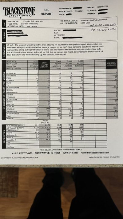

Latest report. 5K miles OCI, 16 OZ Lubegard, RP 20-500 filter. PUP 0W40. This was with less towing hence the viscosity improvement. Confirms with this recipe if you tow a lot need to change the oil before 5K. At least for me.

What was the oil you ran at the 70k interval? Looks like that was lowest wear.

In the previous oil changes, were you using PUP 0w40 without the Lubeguard? If that is the case, looking at the report, I'm thinking PUP 0w40 isn't the best oil for the 6.4, even though it bears the SRT logo.

Even the 0w40's, wouldn't that be newer reg? I am out of the loop. Well the uoa itself hints it is a new regulation as the other two were not di.

I started LubeGard at 65K miles. So.....the 65k sample is just PUP with Wix XP filter. Can't remember the "towing load" during that cycle. I've used PUP since day 1 with the exception of a couple of changes at the FCA Engineering Service facilty as this was my PE (Product Evaluation) vehicle initially when I worked for FCA. I bought the vehicle direct from FCA after I drove it since day 1 during the PE 1 year cycle. The couple of changes by FCA was PP 0W40 which I believe was the factory fill back then. Historically, I used the WIX XP filter until the 65K interval. RP 20-500 after. Always a 5K OCI even early on.
