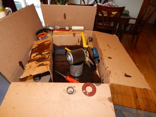

Back when I had my 6 speed Ram I used to replace both filters with each fluid change. Then one year after 50K miles I opened up the spin on filter and thoroughly examined the media for metal sludge or flakes. At 50K it was still sqeaky clean inside. So I decided going forward on that truck to change every 100K. The zf only has one filter so there's that. Here's a pic of that filter. Opening inside the house was a dumb idea, but it was freezing outside. This was eleven years ago, I posted details on another forum. Wife wasn't happy when she got home. LOL!

Back when I had my 6 speed Ram I used to replace both filters with each fluid change. Then one year after 50K miles I opened up the spin on filter and thoroughly examined the media for metal sludge or flakes. At 50K it was still sqeaky clean inside. I decided on that truck to leave it alone for 100K. The zf only has one filter so there's that. Here's a pic of that filter. Opening inside the house was a dumb idea, but it was freezing outside. Wife wasn't happy when she got home. LOL!
Yeah, it's more efficient than the sponge pre-filter, but still more of a rock catcher to ensure sufficient flow rate through tranny's.
