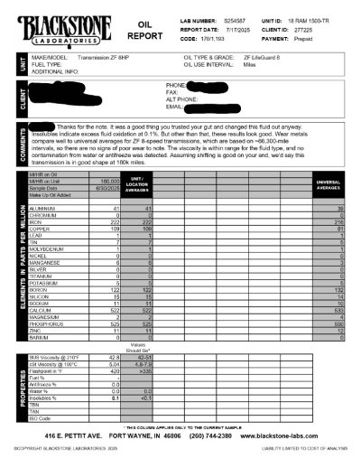

I posted a couple of threads last fall mostly for advice regarding the zf8 fluid change on my 2018 Ram 1500 3.6 4x4. (thanks for helpful tips). I promised I'd send the used fluid for testing analysis to see how ugly it would be at this high mileage. Just for context I had a relatively gentle 160K miles, no towing, very little city driving. (I'm at 172K now, I replaced with Amsoil SS fuel efficient ATF) Here's an image of the blackstone report.

Big wow, thanks for doing this and sharing this. You can compare your report to others at BITOG.
There is an example over there of a transmission first oil change was at 450k miles or something like that.

Thank you for posting your UOA for high mileage OE tranny fluid. I've been curious as to how long the fluid is "good". Changed mine at 142K over a year ago, saved a sample, may as well send it in and post back with results.

Back around 2019 or so I changed the fluid in the ZF 8speed in my Jeep Grand Cherokee ecodiesel. Had 166K miles at the time. Sent it in and got very similar results, which surprised me at the time. I think I posted the Blackstone analysis on an Ecodiesel forum back then, I'll have to see if I still have it
Anyway, this gives me even greater confidence in these ZF's. My current 2019 Hemi Ram has 173K miles and I've changed the fluid only once. Probably time to order a new filter from PPE.

If a guy changed it once, say at 80k, and then again at, say, 175k miles, that means about 1/3 of the fluid that wasn't removed initially will have 175k miles. Fluid which was left over after the initial 'Typical' drop-pan-&-new-filter change.
It's good to know the results at high mileage :waytogo:
Thanks!

On my vehicles which have a dipstick & fill-tube, I usually pump all the old fluid out of the torque converter during tranny fluid changes ..till it runs clear (100% new fluid). Not so easy on the ZF w/o a machine.
But the analysis shows it's probably just fine to do the easier and safer pan-drop method.
