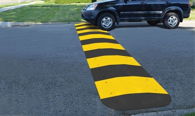

BossHogg
some smaller malls seem to be used as a way of cutting off an intersection, so they don't need to wait for a signal light.
The owners of the property need to install something similar to this, or have a Paving company come in & build them out of asphalt
That would really slow down those low riders
