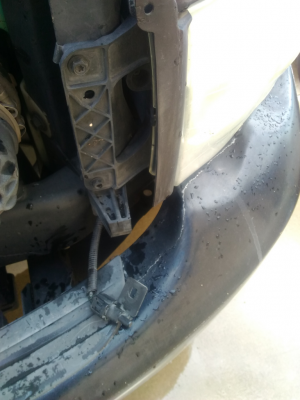

I recently moved to snow country and understand my 2005 Ram with a Cummins has a block heater. This cord was located by the driverside headlight, is this for the block heater? upload_2021-2-26_14-7-1.png

The block heater is on the passenger side of the engine right around the back of the oil filter.ctdblkhtr.jpg
The block heater plug will have standard 3-prong plug that goes in the wall, the heater itself is 750 watts so most appliance timers can be used to turn them on/off a couple of hours before you head out.

This cord I pulled out then might be a ambient temperature sensor.

Gary, you are right the cord you pulled is the ambient temp sensor.

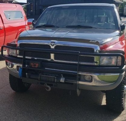

We use Block heaters regularly. Most of us have an extension cord already attached to the plug and wrap the extension cord on the winch bumper etc so it is handy for use. Personally I have a extension cord holder that I can wrap a 25' cord on. Canadian Tire sells them, called Zerostart Extension cord holder. Can be mounted to the bumper or your grill..
shopping
You can see it and the extension cord mounted on the left side of the winch carrier.
