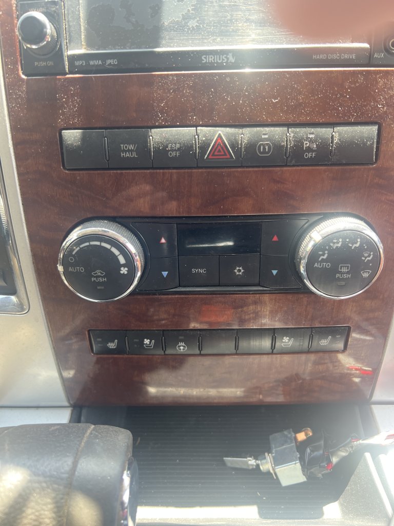

2020 Lariat, A/C is working fine but the blower motor quits working. When the problem is present I have battery voltage to the blower motor but not ground. To temporarily bypass the problem I have cut the ground wire and added a toggle switch that is grounded to the body. Any help would be appreciated. image.jpg
