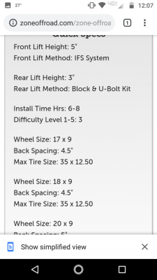

I have a 2005 ram 1500 quad cab 4wd short bed . I want to lift it 6+ inches. I only can find two 5in suspension lift kits (rough country and zone offroad) for my year 4wd with independent front suspension. So I decided I would like to do a 5" suspension lift by zone offroad and a 5" body lift by performance accessories (for my exact truck). I have 33 tires should I go bigger tires? Will it be too tall to be road legal in PA? PA law is no more than 9' tall and bumper height of 27" front 29" rear. The body lift comes with bumper adjusting brackets. Can I just put on custom lowered bumpers? Current ground clearance before either lift is 17" with the current 33" tires. Thanks guys!

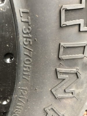

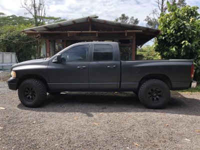

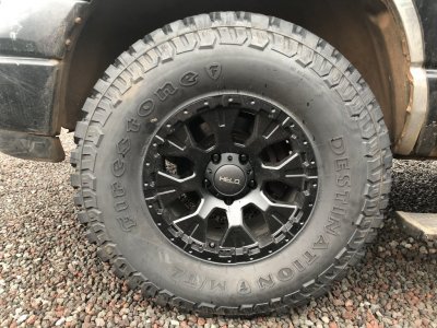

6870FFF1-10BA-4E8D-8D24-7ACFB76B8F98.jpeg 585557CE-73FC-4686-BDE1-E3D62F37A4FD.jpeg 77DC8B05-B25D-4A79-A28D-0A0FF5F011F7.jpeg I put a 2” leveling kit on my 04 1500 and wrapped some 17x9 Helo’s with 315/70R17’s (basically 36x12.50/17) and the only issue I have is a very minor rub on the back side of the front left wheel well during full left turns. I was thinking about adding a 1” body lift, but I can only find 3” minimum.
