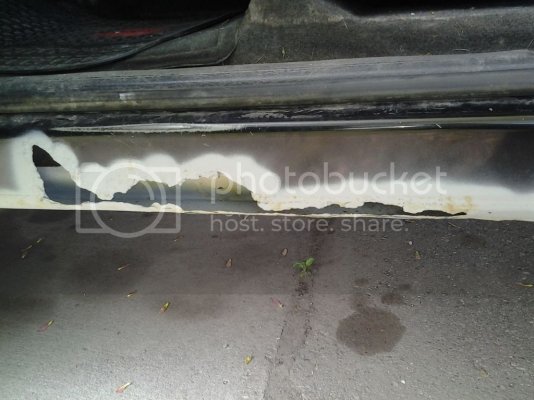

I have many rust hole-spots in my truck that need to be fixed. My biggest concern is my rocker panels and cab corners. Then there is the lovely Dodge Ram bed that rusts out like a MF. If any one has had these problems and know any tricks please let me know. I will post pictures of the RUST...

Thats gonna have to be all cut on and new rockers welded in...not really any tricks or ways around it.

How do your cab mounts look? Any of them rusted? I mean, if you can fit and weld, this is an easy job...and could be a VERY expensive one if you hire a shop to do it.

Well, you can get new rockers and cab corners from LMC...that would bring parts cost to $680...you could go the eBay route on them...My best guess man, is you would be in it for about another $700-$1000 before paint.

There are lots of companies who sell panels
Same quality or better as lMC and more inexpensive
Definitely have to cut and weld
I would use etching primer then maybe bedliner if you don't wanna get into paint

IMG_20120429_164713.jpg Before
BodyWorkWIP.jpg Middle
FINSHEDBODYWORK.jpg Finish!
This it my passenger side of the truck and i didnt want it to look liike the driver side. Duraglasss and bondo as a finish. For the Final paint i use Truckbed liner. So it would last awhile! Tell me what ya'll think?

Not too bad brochacho.
Is that your Y-Pipe with rust on it too? How does the underbody look?
Just as rusty?
