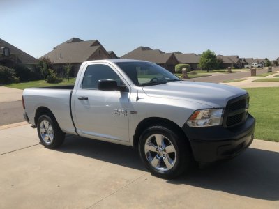

I recently bought a 2016 1500 Regular cab. looking to add performance, but besides an exhaust system and a new CAI, not sure what to do next. also looking for recommendations on what mufflers would yield a deep loud growl in lower RPMs.

Oh, and post some pics or somebody here will call you a liar!

Looks like a sleeper. Save your money and go with a Corsa exhaust, AFR headers and an unlocked PCM with a custom tune where all you mods can realize their full potential. If your truck has 3.21 gears I would also think about upgrading to 3.92's. A gear swap alone would make a hell of a difference all by itself.
