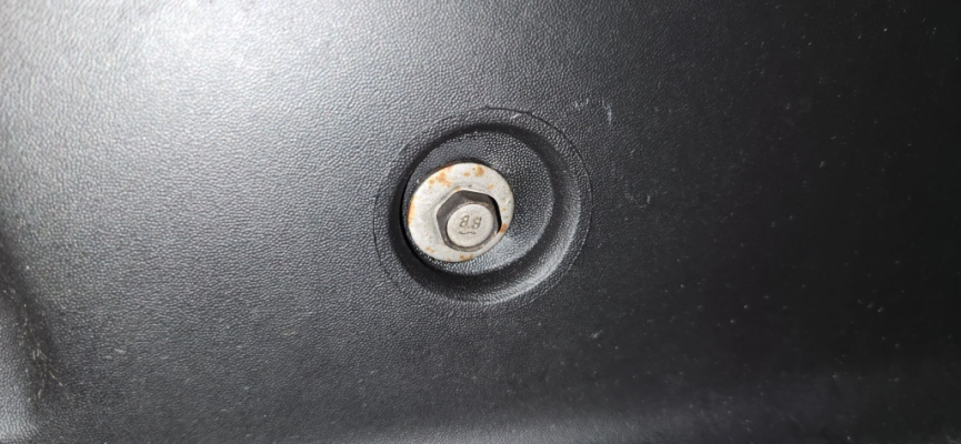

They are bolts, there are the quick clips that they screw into
You are correct, I thought it was plastic rivets all the way around but it's just at the far corners. I think this is what you are looking for...
OR this...
On mine it looks like the latter, part number 6104370AA

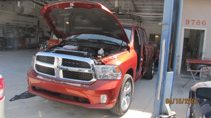

I did s sport bumper conversion on my 16 Laramie. I think I have a complete parts list with all the part numbers. Let me look for it.
They are 10 mm bolts into j clips.
Watch this video.
In the description link of the video is a complete list of all the parts and tags to where to purchase. 2:15 in video he shows the bolts and clips
