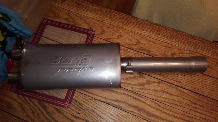

I installed a Borla muffler on my '13 QC in July. I thought it might be helpful to share what I used and what it sounds like.

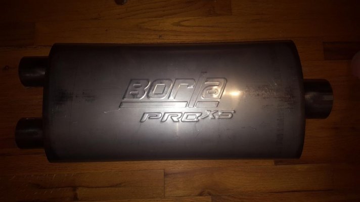

I used all stainless...muffler, extension pipe and clamps:
Borla Pro XS muffler part #400486. It's 3" in and dual 2.25" out. This part # has slotted inlets for clamping rather than welding.
1 x Walker stainless 3" band clamp (lap joint)
1 x Walker stainless 3" narrow band clamp
2 x Walker stainless 2.25" narrow band clamp
Approximately 17" of stainless 3" pipe with 1 end flared to 3" ID. Got this from a local shop that I've been going to since I was a kid :) I started with 2' and cut to fit. I'm not sure if a regular cab truck would need less.
I finally adjusted the tailpipes this morning so that they were lined up how I wanted them. It's probably worth noting that Walker also sells replacement clamps for the swivel joint on the tailpipes. The part # for those is 36523.....just in case you break one, like I did lol.
Unfortunately, the OE muffler did not survive the process as I was forced to cut it off due to rust. It will be fondly remembered for it's visual impression of an oil drum, weighing more than Shaquille O'Neal and sounding like a giant hollowed-out catalytic converter.
Video with muffler installed:
https://youtu.be/zUlcdniY1eA
Muffler:
Parts
Assembled as it went on the truck

One other thing worth noting....you will have to grind the alignment pins off of the tailpipes to get them to fit into the muffler with enough depth. The 3" mid-pipe also has an alignment pin but it's far enough forward that it isn't a concern.

Really like your setup as I miss my old Borla cat back. What did you do for hangers? Or is the muffler simply suspended from the piping?
It's suspended from the piping. It's rock solid, the mid-pipe has a hanger right in front of where my extension pipe joins the OE exhaust.
