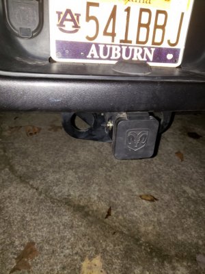

I got my airlift helper bags in today. My craftsman 3 ton jack seized up so i had to go get a husky 3 ton from home depot. Install was easy enough, took about 30 minutes driver side and 15 to do the passenger. Quickest way was jack up, remove wheel, fish the airline first,deflate and fold over, inserted halfway up spring at the largest opening, let a little air out, cap it, then put the red puck and hook up the airline. Ran the lines through the trailer hitch and out each hole, used some washers to close the gap. So far so good didn't bottom out at all on the roads back home, which normally there's 5 spots. Was going to trim the bumpstops where they hit at the edge, but not an issue so far. Running 18psi in em.
