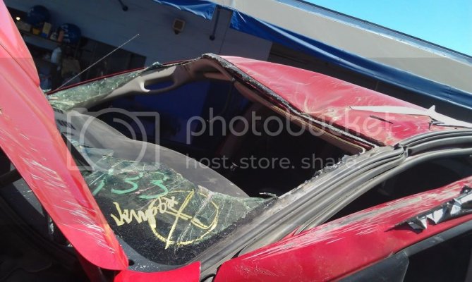

This is how I got it
After replacing some parts: Hood, Fenders, Roof, Doors...
I have what resembles a very ugly truck!

****, how the hell do you change out a roof? That must be a time consuming project to get everything to line up perfectly!?

I will start off by saying I've never done anything like this truck before... I was told it can't be down and laughed at by some acquaintances and friends, and after about a weeks worth of work it's looking like a truck again, I'm gonna baby the paint job just so I can tell the doubters to shove it. :D
Sadly I didn't take pictures of the process of the roof...that was by far the biggest PITA.
But I'll explain it for anyone that dares to venture down this path...
Had a few choices on what to do with the roof...
Other bodyshops, know-it-alls, etc. said the ONLY WAY to do it would be to buy a new cabin... or a junkyard Cabin, so my first step was shopping for cabins for a quad cab...yikes...
Prices of $2500-$3500
..plus the time to take it all apart...NO THANKS
1. Put in a Sun Roof! The roof was so bent and mangled there was no way of straightening it out.. This would of been very custom, and we're not great at custom! Wanted mostly stock look...
2. Cut a Roof at the posts and weld at the posts
3. Buy a Roof skin, straighten the posts and remove skin and install new skin.
$New Skin is $800, still needed two doors, plus other parts
I found a junkyard that was willing to work with me, he cut the roof at the posts half way...and two doors, wanted $1200, haggled down to $800
Removed the skin from the old roof from junkyard and skin from the broken roof on the Truck.
The roof came off of a 2500 and it was a BITTTTTTTTTCH to remove from the roof frame.
Bought a windshield glass to help with making sure the frame is straightened properly and began mounting the 'new' roof skin.. took about two days, with the help of another guy.
Got to learn a lot about how Dodge built these, the sound deadening adhesive helping hold the roof panel to the frame was a nightmare...
Welding everything back, grinded the welds a little, put the moldings back on, and we were surprised ourselves how great it turned out..
The first clue was when the windshield guy who sold me the windshield came back to install a new one (cracked the windshield in the process) and said he's never seen such a good roof repair.

As far as what accident it was in...
AT first I thought he may of hit a cyclist...a very overweight cyclist.
But after inspecting the whole truck, it looks like he was going fast and most likely lost control or slipped in rain/snow and when off the road..
I'm thinking it went off road and went under a branch, or possible broke a branch on top of it, it also had a lot of damage on both sides...
Perhaps brush? who knows.. I am by no means CSI but it was fun looking around and trying to figure it out
