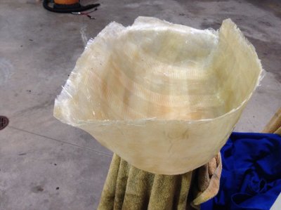

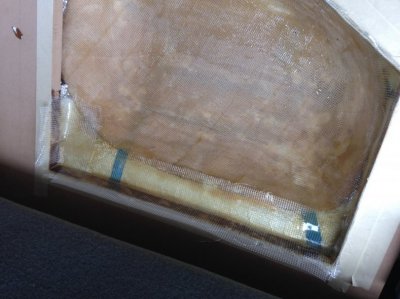

Started with the mold of the underseat trimmed up and added layers for strength

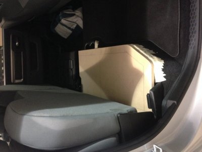

Made the bottom part of the box, this will be attached to the fiberglass tub. It is the same size as the fold flat floor to match the theme of the truck and the other side

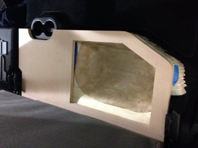

Made the opening for the tub for attachment.

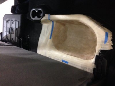

Started attaching the tub to the box frame.

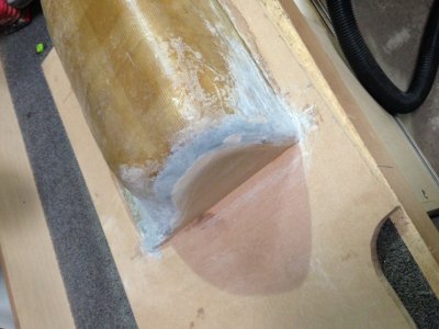

Measured the interior volume with water and kept the side open cut to the right size as the interior volume needed for specific sub and capped at correct size. Glassed and bondo in place, shwing!

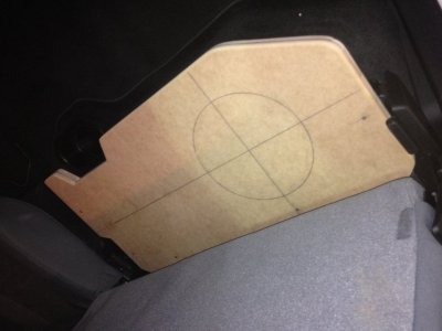

Chopped and routed up the top piece to go on the bottom tub/frame assembly started planning on sub placement

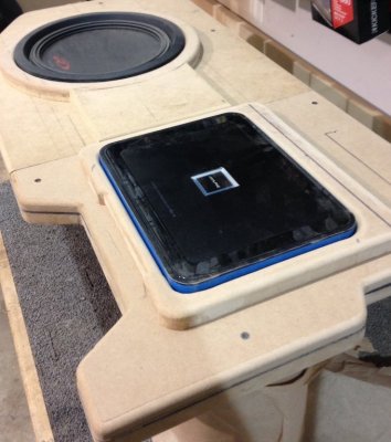

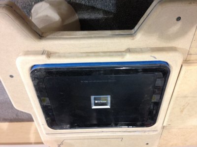

Made some openings for the sub and amp tray/ kept the tray large for future amp size change possibilities. There is a trim ring going over anyways. Later on in the build I ended up changing this to be exact for the pdx

Few changes with trim rings, and some terrible picture angle

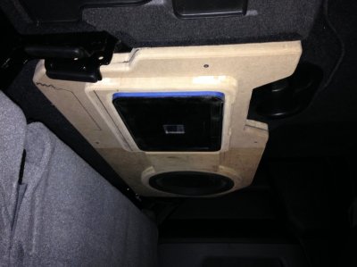

Lil closer but still bad pic. I'm modding holes in this for led to shine through from amp

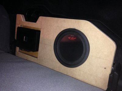

Last one for now. Gotta do a couple other mods but it will be off for line x
Soon.
I am debating on Polk MM 6.5 comps and 6x9s to keep this simple. Maybe running a kicker front row to tie in signal from the head unit. When ever I get around to doing the actual wiring.
fun stuff! I'll keep yall in the loop

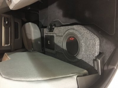

I decided no no thank you on line x and went with carpet...
