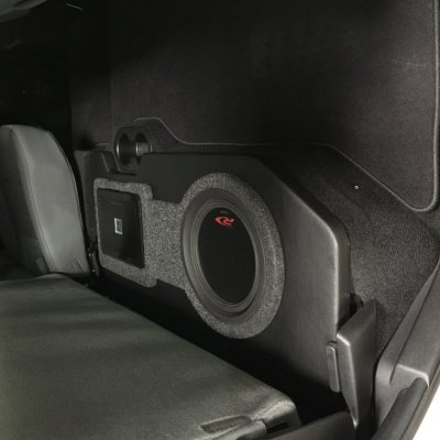

looks nice..
the only thing i would have done differently is maybe wrap that trim ring around the amp/sub in a black vinyl or something.

Haha I wanted to. But I have an abundance of grey carpet and I got restless to finish. Original plan was black material. Maybe I will change it up. Thanks tho

That looks awesome. When I get sick of my ported box, I'll have to try and build one thats half that nice.

Thanks! I'm going to make a few more and play with different ideas.
I'm not in the business at the time being but may go back if the right placement calls!
