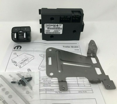

I currently have a Tekonsha P3 that I am replacing with the built-in brake controller. I am 6'7" and the Tekonsha just gets in the way of my leg and I prefer the clean look of the built in one. I am wondering if there is any functional difference between the OEM (Continental) module and the aftermarket modules such as those found on Amazon or eBay? I am mainly concerned with the Evic/Radio integration. I know I will need to get it activated, and will likely use AlfaOBD to do that. I typically go for OEM most of the time, but the OEM one is $2-300 versus the $60-100 for the aftermarket and since I only use it a few times a year to tow a 1500 lb popup camper, I can't justify the 2-4x price increase.

The biggest question is how well an aftermarket integrates with the truck electronics. The OEM one use information from the ABS and vehicle stability modules along with braking force and vehicle speed to determine trailer braking force.
I want to say some people have had issues with aftermarket OEM style brake controllers integrating with the truck. Although there is three different modules used in the +13 trucks
The Mopar part numbers for the ITBM kit by model years:
2013/14 = 82213474AB
2015 = 82214492AB
2016/17/18 = 82215040AC

I purchased a OEM style (after market) controller along with alfaobd and $13 Bluetooth adapter from Amazon. It installed and tested no problem. I am still waiting to take the trailer on the first trip though to see how well the new controller works.

WEILEITE Integrated Trailer Brake... https://www.amazon.com/dp/B096VK119W?ref=ppx_pop_mob_ap_share
So far so good. No issues activating it in the evic or the radio. It recognized the trailer is connected, but haven't towed it anywhere yet. The finish is just barely different for the buttons but most will likely never notice it. The buttons are responsive and feel solid.
