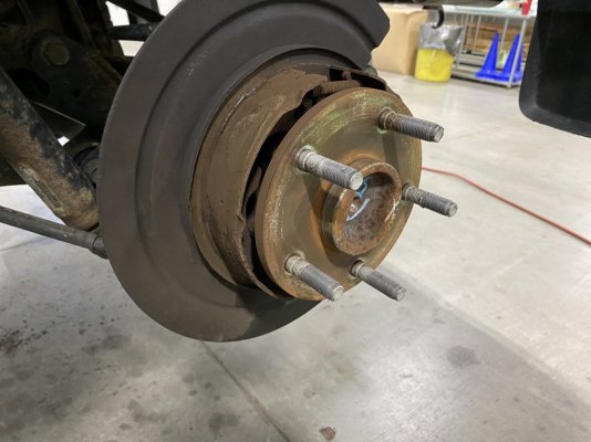

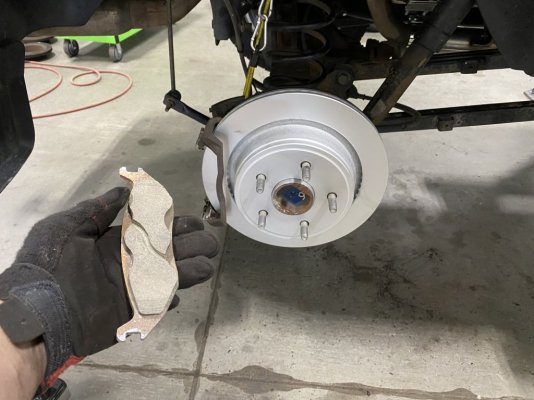

Got the rears done this weekend, they were definitely due. So far I like the Wagner OEX pads, they grab well and are quiet. We'll see how they last. The front will get the same combo soon.
Gonna have to do a complete parking brake job as well. Wanted to wait to inspect, should've just gone ahead and gotten everything :rolleyes: I think from Napa it's around $220 to do new LH/RH cables, intermediate cable, hardware, their cheaper shoes, and the levers.

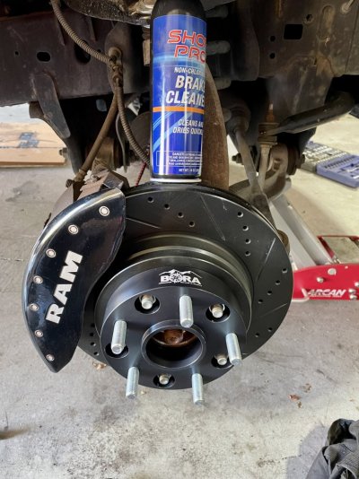

I have to do brakes on my 2019 1500 classic With 5.7 in it as well i just priced out a set of 4 cross drilled and slotted rotor and ceramic pads $577.17 CAD Tax in!
you get what you pay for ! I like to push the skinny peddle and go sometimes and I like to stop all the time ! I also tow a TT in the summer

What kind of mileage are you guys seeing for your parking brakes to look like that? Do these trucks keep some pressure on the drums all the time? That looks like a pain and like something I shouldn't need to worry about at 50k miles.

It's a bad design from the factory. Do a YouTube search about replacing the parking brakes on these trucks and you'll see. The cables pull a lever that goes through the backing plate and actuates the shoes. That lever gets corroded and hangs up. You'll set the parking brake one day and it'll seize, you release it and *most* people wouldn't catch that there's an issue and it just gets driven with the parking brake on till you burn up the shoes.

That sucks about the parking brake design. I use mine regularly as my other car is a manual so it is just habit. Hoping that will keep it working for longer. Hopefully mine are still in good shape and I can shoot a little grease on it and wait until the next pad/rotor change to deal with it.

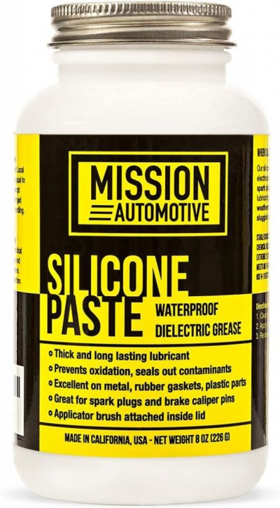

Many miles later still no dust, no noise, no fade, no problems at all. I do lube all slide pins at least once a year with silicone paste. My Ram hits the track once in a while and the Beetle does delivery so lots of stop and go traffic and brake slams when idiots pull out in front of me. I highly recommend them but you must do the break in procedure. My buddy didn't and has some vibration.

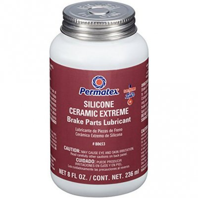

What is everyone’s/popular lubricant for the caliper bolts/slider pins??
