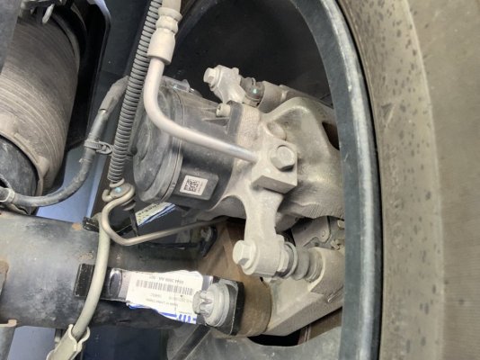

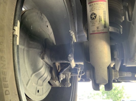

Bravo619
Jul 7, 2021
15
13
Tulsa,Ok
Hemi 5.7 gas
Also I can vouch for this anti moan kit . That it does indeed fit the 2021 ram 1500 unlike what the dealer and the aftermarket seller said ! So just because it says it won’t fit your vehicle don’t believe everything you hear.
