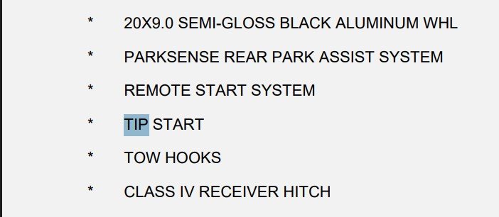

A friend in the biz (a Toyota Master Tech) thought there was a possibility of it being operator error. That being since I was use to the push button start on my old truck for so many years, my muscle memory for how hard to push that button to get that truck to start, and getting a new one with a different start button I might have been unknowingly pressing and releasing the start button too quickly and not far enough for the starter to engage and I would receive a service message because the truck failed to start. Admittedly since the last time the new truck failed to start I have been much more conscientious about how firmly I press the brake pedal and start button.
Nope. Most, if not all gen 4 trucks have TIP start.
(excerpt from my '21 Warlock Equipment listing)
Starting or stopping our trucks is a digital command, on or off, no part-way or in between.
Run your VIN equipment listing here.
Starting our trucks is a digital command, on or off, no part-way or in between.
Funny thing is, when I had TIP start I always used it like an actual key.
Reality is you just need to "crank" it to the start position once then let go. No need to hold it like you're starting an old school vehicle.
