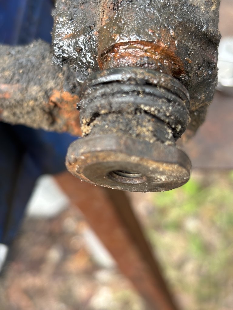

i just did the front brakes on the sqids truck. wow what apita. passenger side the rotor was rust welded on pins seized in the bracket. i beat the rotor off with a hammer (BFH). then put the braket in the vise and sprayed and twisted hammered heated. after a couple of hours it came out. a couple of days later wheel bearing was done that involved a bit more hammering and swearing etc. the kid god bless him wants to do this himself but he is not strong enough. i’m not as strong as i used to be either now that im older and dieing. but at least he’s trying and paying attention
