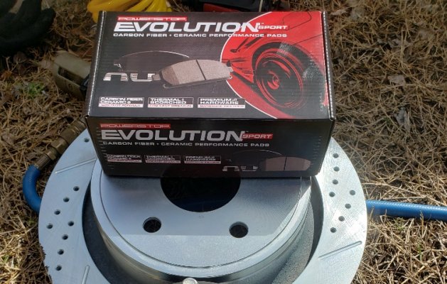

Power stop rotors with their pads or the EBC.
Power Stop K2163 Front Brake Kit with Drilled/Slotted Brake Rotors and Z23 Evolution Ceramic Brake Pads https://www.amazon.com/dp/B005FL2QLU/ref=cm_sw_r_cp_apa_i_zvx9DbSAT3489
Power Stop K2172 Rear Brake Kit with Drilled/Slotted Brake Rotors and Z23 Evolution Ceramic Brake Pads https://www.amazon.com/dp/B005FL35UQ/ref=cm_sw_r_cp_apa_i_Xvx9Db04DW03F
Hope this helps... I'm totally sold on them. No matter what you get, break in the new brakes correctly... Look on power stops site, they'll give instructions.
