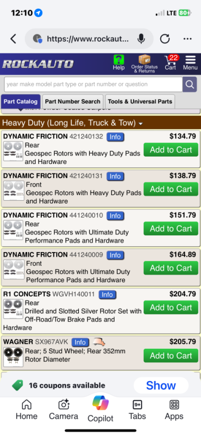

I’ve been looking at the power stop options under the “Heavy Duty, Long Life Truck & Tow” category.
They are making references to a specific rotor size. How do I know if these rotors will fit my truck? I’m searching it under the category for my vehicle. But I thought I would ask before I place an order. And it looks like all of the Power Stop products come with ceramic pads. Are they good or not in the Ram Trucks. I changed the left front caliper and brake hose the last time. I’ll probably change the right side as well. Any better brands of calipers for these vehicles?

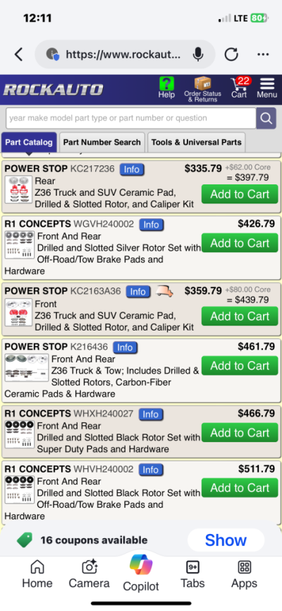

I see that Power Stop HD trailer/tow rotors & pads (Z36) have different options.
Have you guys kept the original calipers? I have 131,000 mile now. I see that Power Stop has a package with front & rear rotors, pads and calipers. Have any of you guys tried the Power Stop calipers? Also are there any better brake hose manufacturers for a 2015 ram 1500?
Thanks!
Thanks!
The Z36 set is what I put on my '16. I have never had a truck stop this well and that's been since the '70's. I kept the OEM calipers and had zero problems with the install. Just be sure to change all your brake fluid and bleed it well.
Don't know about the hoses specifically, but I get my braided brake lines for Summit or Jegs racing. Going to a S/S braided hose you will immediately feel an increase in brake pedal stiffness, as the braided line doesn't swell like the std hoses when pressurized.
Just a warning. Follow the break in procedure to the letter.

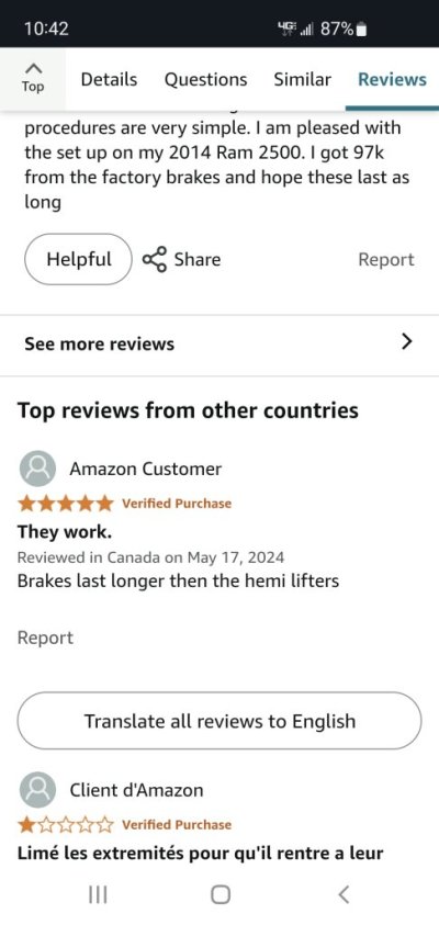

Now you got me thinking about a set (I plow with mine so it's hard on em)
So I decided to read some reviews...sounds like a Mopar guy to me

PowerStop Z36 kit.
Kit also comes with new caliper slider clips and rubber slider pin boots.
You won't be disappointed with these brakes.
Just make sure you follow their recommended bedding in process.
