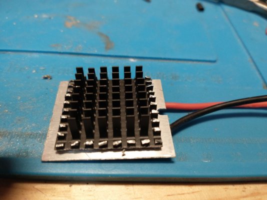

I originally just sanded the sides to fit and left it dangling behind the clear panel in the overhead. Great lighting almost blinding. Well after six months the LEDs burned out due to lack of a heat sink.
I recently bought some heat sinks for my 3D printer and had extra. So I cut and ground to fit another.

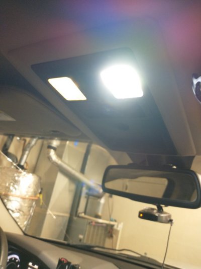

In the pics i tried to have a fixed exposure to compare a 194 LED vs the panel LED.
The kit comes with plug and play harnesses. Makes it easy to swap out new ones but i lost the connectors to another project. So i added silicone insulate wires
Heat sink cut and trimmed to fit.
In console compared to normal 194 LED.
regular LED.
LED panel.
The panel kinda just flops around, but its not noticeable. Hopefully this last longer than 6 months, but just in case, i have 5 more kuts on order.
