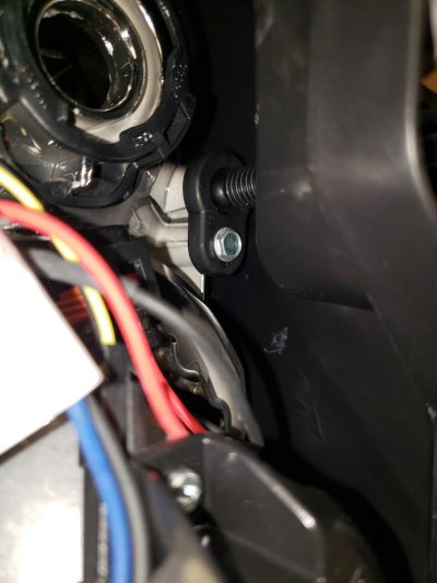

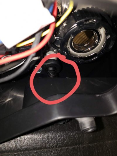

ill add pic tomorrow. i was trying to raise light beam and turned screw too far. projector light dropped down and wouldnt raise again no matter how many times i turned screw.

Sounds like you turned the screw too much and might have stripped it. Might have to separate the light and see if you can get it remounted.

Is this the part ?
I have never looked at mine
bottom attaching bolt

seems like the end is a ball and its out the socket
Turn the adjuster the opposite way, it'll force the ball back on to the socket. Once you hear it pop, stop so you don't pop the other one off.
If you can use your finger and put it in the hole for the light bulb, pull back on the reflector part and then go the opposite direction with the screw to get it back on.
