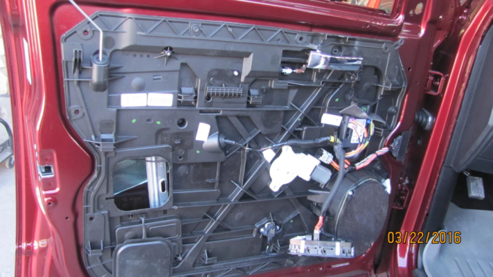

That happened to me on my 2011. Window regulator blew up. They aren't your old fashioned regulator, they are a whole panel with the regulator and motor attached. Think of it as an inner door panel. Picked up one from Amazon, with the motor, for $120 or so. Dealer was over $400 and there was only 1 dealer in the nation that had one.

watch this video, it shows everything that you need to know
Something that he should have mentioned,
When you remove the 6 screws that hold the panel in place, there is a little black rubber ? washer that will fall off in some cases. You need those washers, so do not remove those 6 screws over something like Grass or Gravel
