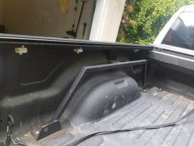

I have the top rail ones on mine. Back ones is an ooen hole, but I trimmed the sleeve. Front you have to trim a hole in the plastic, but not the entire cut out. The drivers to passenger side cut out lines are good, but front to back is about 1/2" inside the cut out lines on both edges. Did it with just an exacto knife. Allows me to tie things down on top of the tonneau or bigger items that make it hard to get to the factory tie downs. I also have a custom set of rails that skeleton the fender wells that are solid and provide numerous tie down points as well as a way to use a u lock to keep my bikes from being stolen easily.

...I also have a custom set of rails that skeleton the fender wells that are solid and provide numerous tie down points as well as a way to use a u lock to keep my bikes from being stolen easily.
Could you post a picture of your custom rails?
