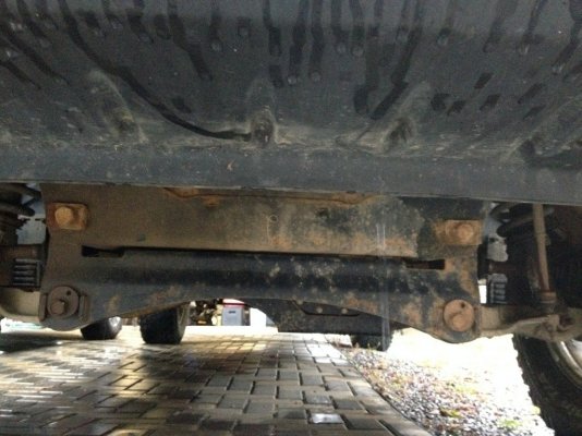

Here's the underneath. It does have a 6" lift and has lived it's life up north. Does this amount of corrosion seem normal?

Look a lot like mine, and I'm not in the rust belt either.
